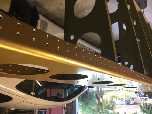

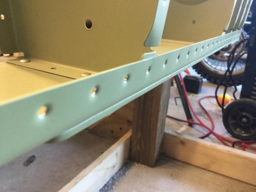

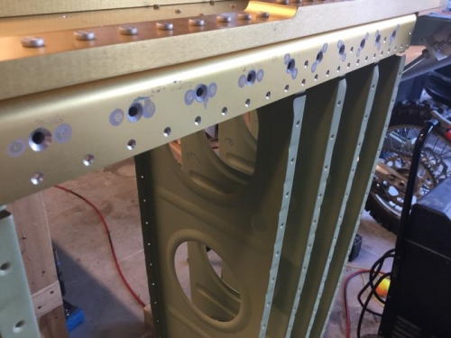

Brief Description:  Dimpling Right Wing Parts
Continued prepping right wing parts for priming and final assembly. Dimpled all the bottom of the main ribs and rear spar. Countersunk all the Main Spar holes. Went a little deep on the few that go under the tank. About .007 below the surface. Should have been .000.
