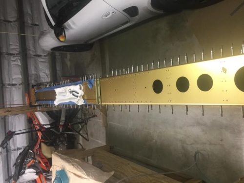

Adjusted the outboard stand bracket to level the wing left/right and fore/aft.

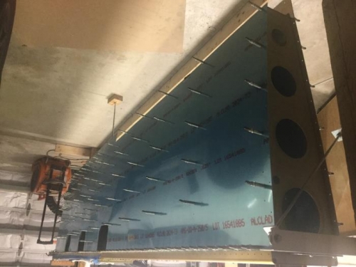

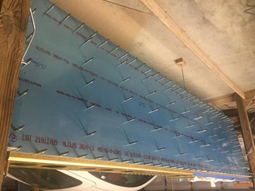

Match drilled all the holes on both the Right Wing Top Skins Holes to the Main Spar, Ribs, and Rear Spar. Clecoed the Right Wing Bottom Skins into place in preparation of match drilling. Left the plastic protection on the inside of the bottom Skins since they will be stored for awhile.
Need to smooth the edges of both Bottom Skins and remove the plastic before priming.
Right Wing Main Spar
