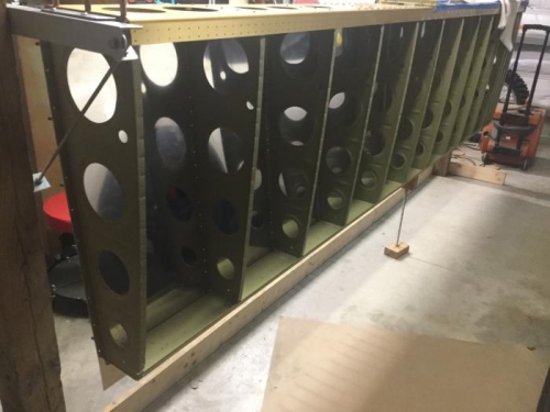

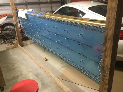

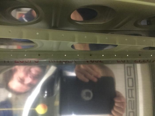

Made the Right Wing Walk Doubler and match drilled it using the Inboard Top Skin.
Deburred those holes in the Doubler and the Skin. Smoothed all edges on both of them and the Outboard Skin.
Clecoed the Doubler and both Top Skins onto the Skeleton. Readjusted Fixture. Need to check square and twist before drilling the skins.
