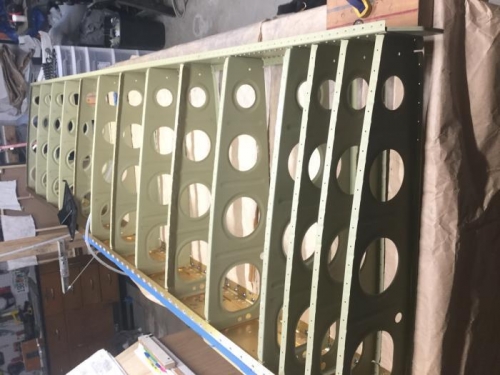

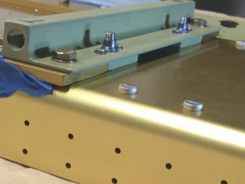

Installed nutplates on Tiedown. Installed Tiedown, Spacers, and Bellcrank Brackets onto Main Spar. Did NOT torque.

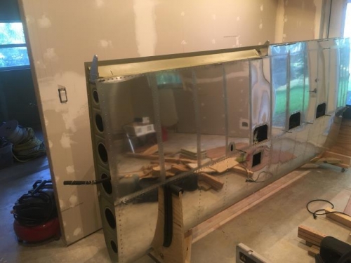

Clecoed Bottom Skins onto Left Wing to protect them a little.
Riveted Rear Spar parts - Reinforcement Plates and Fork.
Riveted all Main Ribs to Main and Rear Spar. Did not rivet outer most rib to Main Spar, per the directions.
Installed inner most Main Rib rivets wrong TWICE. Once without the rib included. Then with the head on the wrong side. This caused the rib flange to have a gap. FINALLY got it installed correctly with no gap.
Need touch up paint on three spots - Web of the front of the Main Spar (from bucking bar slips) and some on the rear of the Rear Spar from drilling out and smileys from riveting.
Getting better with not having smileys next to the rivets, but still get some. Could be mostly primer.
Right Wing Tiedown
Right Wing Tiedown
Left Wing Bottom Skins clecoed
Right Wing Skeleton
Right Wing Skeleton
