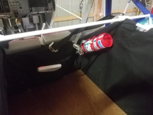

WIth the help of Ted and Bob, I took off the right lift strut and changed the length of the rod ends making the wing tip washout the correct one degree called for. It was slightly off and that was, hopefully, what caused the right stick required in all flight conditions. I burned the holes in the baggage compartment liner that goes over the headset jacks and the control rod and installed the left one. The right one needs some more sewing to finish it. I installed the fire extinguisher permanently too. The weather is supposed to be bad all week so maybe no flying this week. We'll see.
