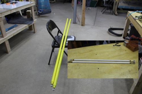

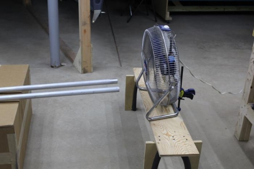

Almost finished with the Aileron Pushrods today but I ran out of MSP-42 Cherry Rivets. The Pushrods were trimmed to the correct length and the threaded Rod Ends were inserted, drilled and riveted in place. The outsides of the tubes were cleaned and primed. I also decided to paint the tubes after priming. I had a can of yellow enamel and used it for that. The pushrods are 95% inside of the closed wings so color is irrelevant. Any part extending into the fuselage and visible would be repainted with the appropriate color. The shorter Aileron Pushrods were assembled.
Drying Insides of Pushrods

Painted Pushrods
Painted Pushrods
