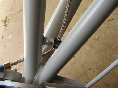

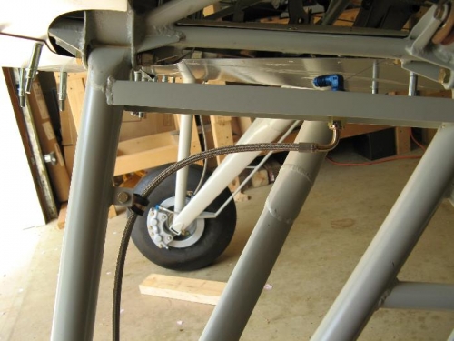

Brief Description:  Brake lines
I used stainless flex brake lines in the landing gear. This will give me one less fitting that will be inaccessable after the gear is covered. These lines are really nice. They come from Pegasus Racing and are available in many sizes and lengths as a stock item. The ends are pressed on at their factory and are tested to 3000 psi. I may use more of these lines in the fuselage.
