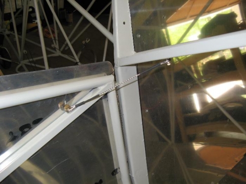

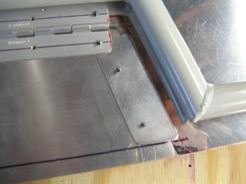

Brief Description:  finished trimming and fitting doors
I had a little bit of work left to do on the doors. Things like trimming so they would clear hinges and trimming so they wouldn't rub. I also installed a cable on the cargo door to keep it from opening too far. Without the cable the door will open too far and the skin would come in contact with the fabric on the fuselage. The mouse door needed 1" x 3" flanges to keep them from swinging out.
