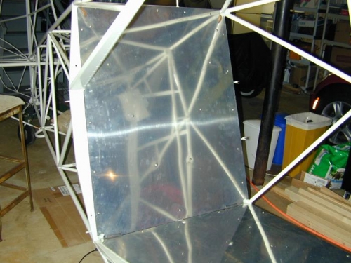

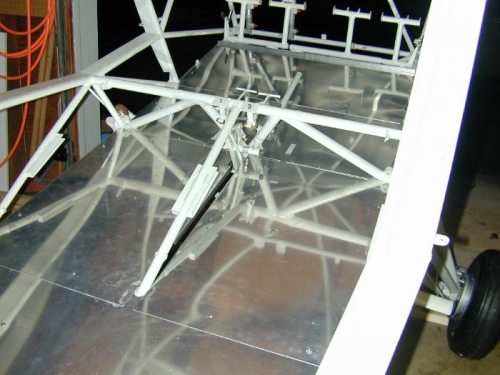

Brief Description:  Floorboards and baggage compartment bulkhead
The floorboards and baggage compartment bulkhead are finished and installed. I still need to install a filler piece to cover the gap in the floorboard between the front seats but that's a small piece. To secure the floors I used monadnocks and #8 stainless machine screws.
