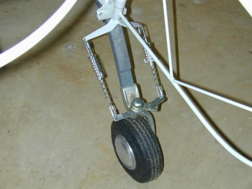

Tailwheel spring
The Maule tailwheel is prone to some shimmy. There is a special spring setup that is supposed to cure this problem. The spring on the right is a bit larger than the one on the left. This should upset any shimmy that may start.
