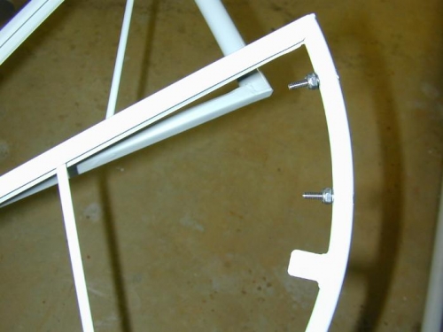

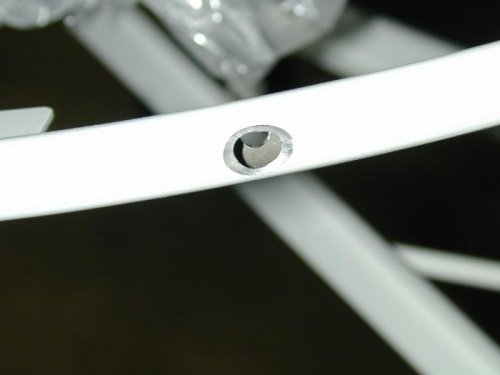

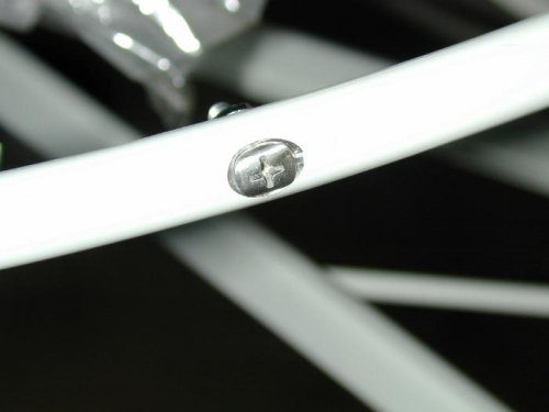

Brief Description:  Balancing elevators
Lead counterweights are formed in the front of each elevator for balancing. In preparation for pouring the lead the plans call for two screws to be inserted through the tubing near the front of each elevator. These screws will give the lead something to grip and help hold it secure. I drilled and countersunk holes where called for on the plans. Then using the grinder I shaped the heads of each of the screws to conform and blend in with the shape of the tubing. The elevators are now ready for the lead counterweights.
