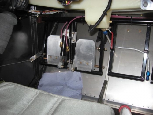

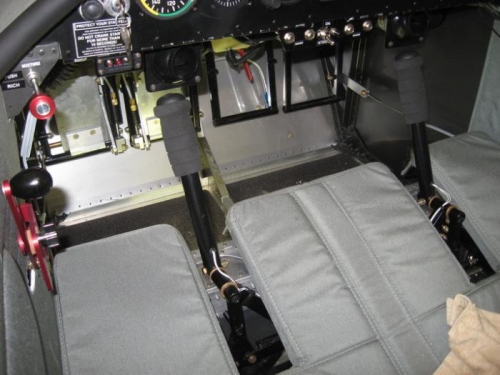

I hooked up the rudder cables .. aligned rudder and nosewheel so everything is straight.
I finished the brakes .. filled them. Still having a little trouble getting a bubble out of the left one. I'm filling them from the bottom up which
normally works. Might just need the rudder pedal at a different angle when I'm filling it.
