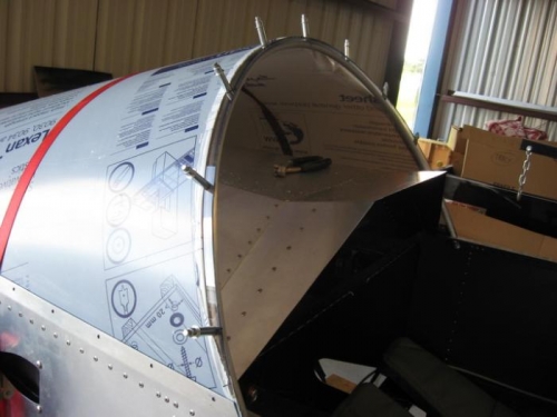

I decided to put in anchor nuts for the front of the windshield .. so I got that done. Then after a lot of slow tedious trimming and fitting I started by drilling the windshield for the front screws. It fit nice .. that worked well.

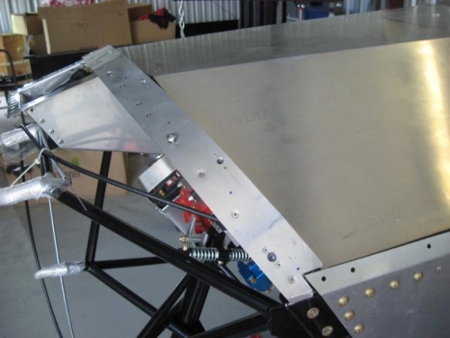

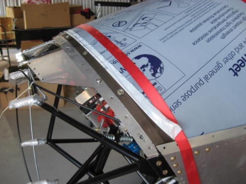

Then I drilled the holes on the bow to 3/32. Need to updrill and tap them yet. I made a drilling block to keep the hole straight and 90 degrees to the windshield.
I've been going very slow and careful on this so I get a good result.
Anchor nuts installed on front
Front of windshield drilled
Back of windshield and bow pilot drilled
