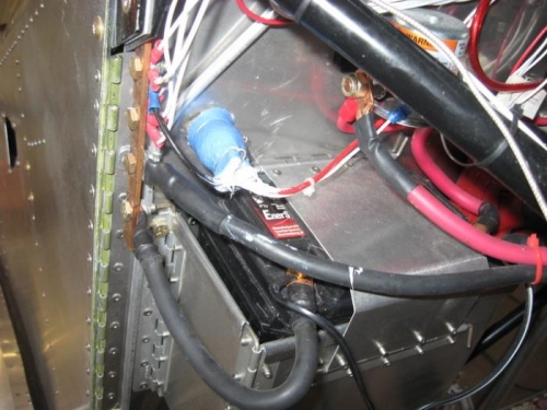

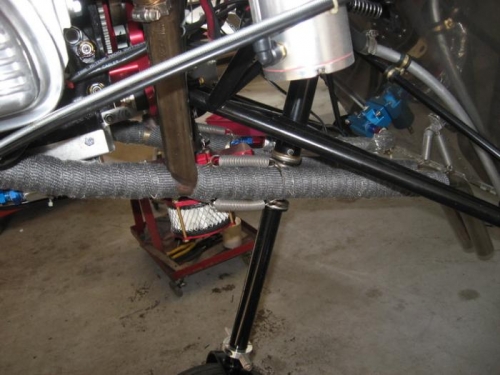

Back to work after a trip up north. I worked on misc tasks today. Header wrap on left side. Had to order a little more to do the rear cylinders.

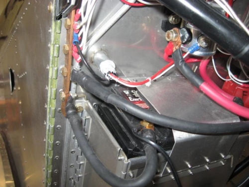

I got the firewall penetrations sealed up. I did this by coating them with 2000 degreee caulk and putting firesleeve over them.
I worked on some safety wiring on the bolts that bolt the accesory plate to the engine. It's not called out in the plans .. but makes me feel better.
