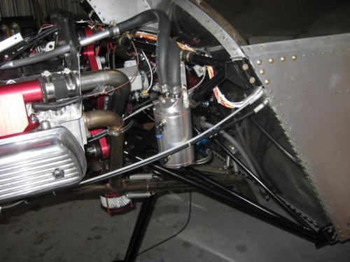

I started out working on the cowling. Sanded the areas I covered yesterday. Applied more of the epoxy/microsphere mix over some other areas. This is a slow process .. but hopefully will be worth it .. reducing the chance of rivets moving and popping up the paint over them. I then worked on mounting a catch can. I'd found one on eBay at a good price. I had to mount new hose barbs on the top to use the 5/8 dia hose. One of the guys who had the right bits helped me with that at his shop.
