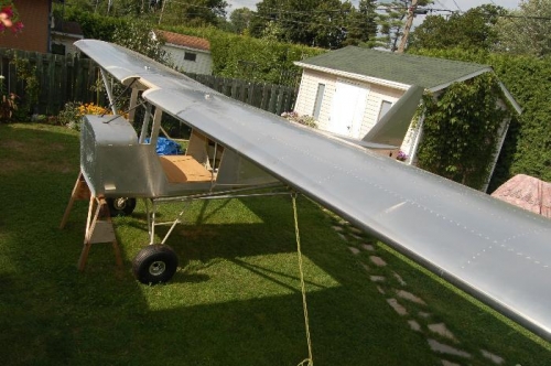

I spent a few hours during the last two weeks finalize little things around the wings. Check and adjust the flap and ailerons movement, make sure there is no binding in the pushrod and set the flap for 30 degree. Set the aileron travel to 25 degree up and 19 degree down. Install stoppers on PF-196. I am now ready to remove the wings from the fuselage and put them back in their big box.
