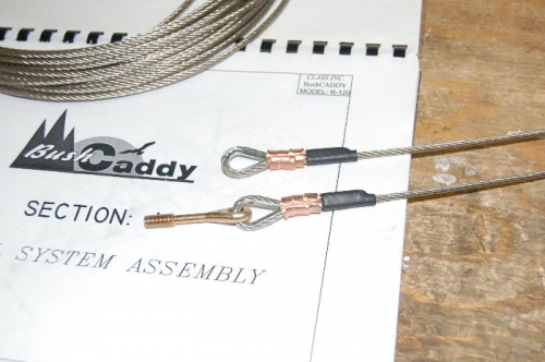

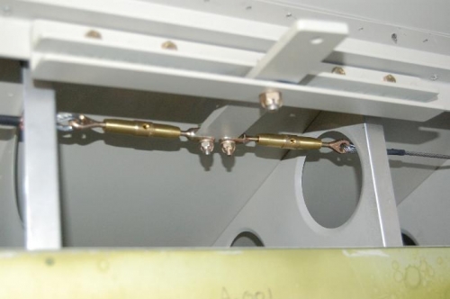

Began with the ends that goes on the torque tube. The end of the cable attach to a AN3 bolt and a bushing. Easy to rig. The other ends goes at PF-196 via a turnbuckle. I tought that the lower pulley was far enough from the side of the fuselage to prevent the aileron cable from rubbing against the rudder cable but.....guess what ! both cables was touching. I had to move the aileron cable pulley about 3/8 of an inch inside. It end up perfect.
