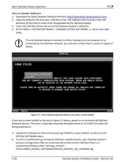

Brief Description:  Dynon software updating
Periodically you have to update the software for the Dynon EFIS. I just followed the instructions on page 3-18 of the Dynon installation manual, see photo below. The refered to USB flash drive came with the EFIS, but apparently you can use any USB stick.
Page from Dynon manual
