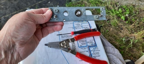

With the antennae installed it was now time to check out the VHF radio and the transponder. Would they actually work?
First I had to install a small part in the back plate of the transponder cage called an RF adapter. This allows the coax cable to be plugged into the rack's back plate. Then the transponder itself slides back in the rack and engages with the antennae (and the D-sub connector for the other wiring). Simple enough. Time to turn on the power.

RF Adapter in transponder rack backplate
