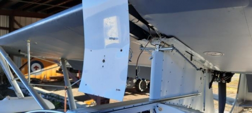

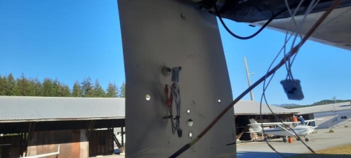

The Dynon EFIS came with an Outside Air Temperature (AOT) sensor and the wiring harness came with the necessary two wires to run from the sensor location, down the pylon, and along the inside of the hull to the location of the Dynon ADAHRS module mounted in front of the instrument panel on the Harness Support Tray.

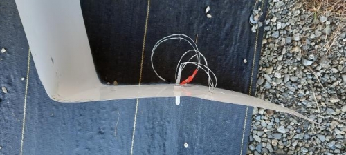

The Dynon manual provides the simple instructions for drilling the hole in the bottom side of the Upper Gap Seal and mounting the OAT sensor.
OAT installed in Upper Gap Seal
