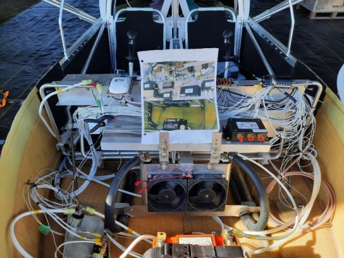

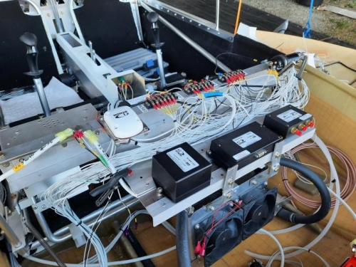

So now with the Wiring Harness Tray extended towards the bow to give more room for both the modules plus the bundles and individual wires to be placed without undue crowding it was time to install the three Dynon electronic modules for good.
Per the Dynon manual I used brass machine screws, lock nuts and washers to secure the ADAHRS module. Longer screws than necessary and extra washers were used to allow for some levelling of the unit in the future if need be.
Checking against Angel's photo
Finished installation
