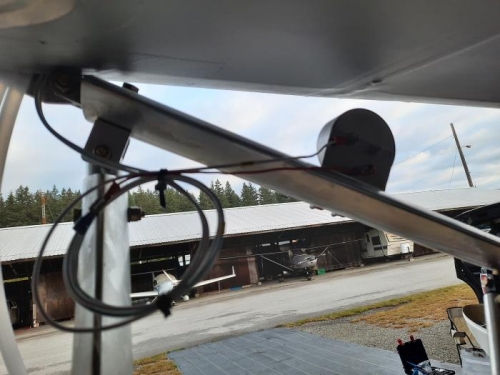

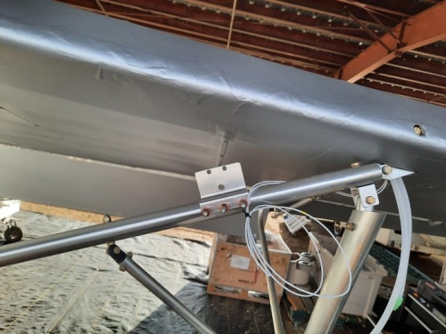

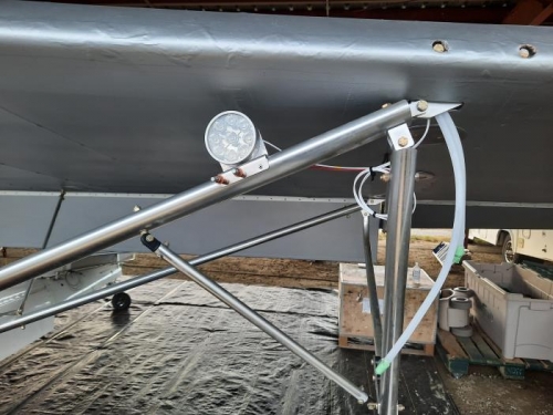

Brief Description:  Electrical - Landing Light install
I fabbed a simple mount for the Landing Light by bending some aluminum plate and riveting it to the port wing brace. The instructions gave major mention of the need to have enough metal behind the light to act as a good heat sink and to smear the connecting surface with supplied heat transfer grease. Need to due a good check during system testing that the heat is being transfered away adequately.
Mounting plate for Landing Light
Back view
Back view
Front view
Front view
