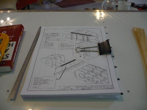

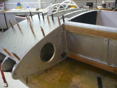

More changes two inner nose ribs re seated
Got a new layout for the configuration of the 4 nose rib models. Talke it over with Jim and he said do it.
Made templates from nose skin to support ribs in their proper location.

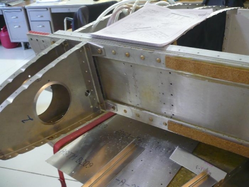

Removed rib 3 & 4 from the left wing. Trimmed and re-attached rib 3 & 4
I inverted the inner L-angle on rib 4 to use and close up the rivet holes that go into the wing locker.
New layout for the 4 nose ribs
