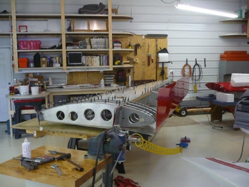

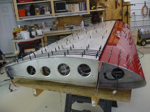

Attached leading edge skin along the bottom and riveted the bottom only.
Installed fuel tank and ran wires and fuel line.
Closed leading edge skin, entire top skin and leading edge are ready to rivet once aileron is in place. May wait for that till the wing is back on the airplane.

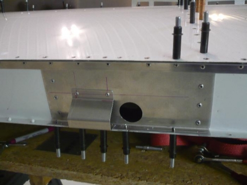

Attached aileron stop for 11.5 degrees deflection.
