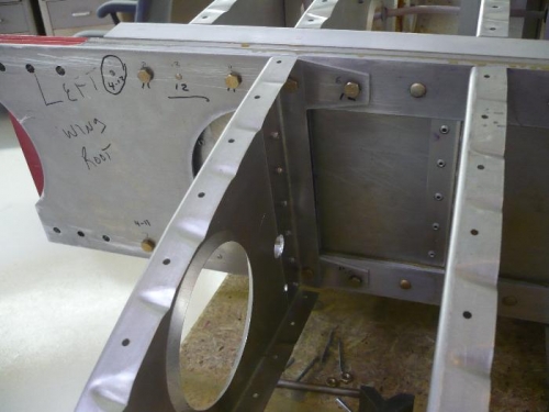

Right wing work
Bolted wing root doubler and finished reaming the attach bolt holes. Torqued all bolts on wing spar.

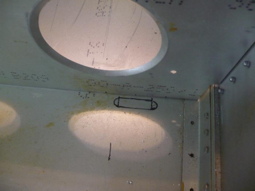

Began desgin layout of the lift reserve pickup. It will be located in the same bay as the pitot tube but outboard near the other rib.

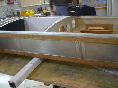

Finished solid riveting and covered heads with cork.
Fuel tanks ready to install once the fuel lines are reattached with fuel lube.
