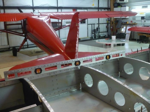

Leveled the right wing and balanced aileron. Need shorter bolts AN3-34 rather than the -37 zenith shipped. Taped cover and some rivets to get balance correct.

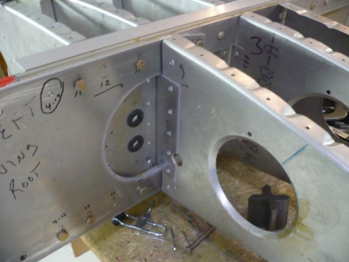

Finished boxing the aileron belcrank area on both wings.
Removed LE sking and attached rib two on left wing.
