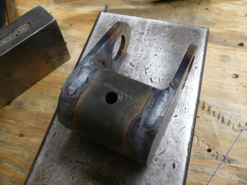

Weld Rear Pivot Plates
Set parts up to weld and welded the plates. Had to spring it back open a little and maching some clearance in to get it all moving freely.
Vent hole
Spring back open
Take a few thousands out
