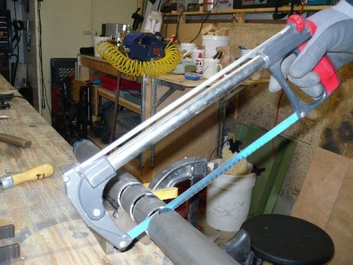

Cut Main Frame Tube
Used a variable speed sawsall and left the line on. Grind to split the line using 3" dia. 36 grit disk.
Used a 3" cut off wheel to finish and clear out the bottom of the cut, removed the line in that area.
Cut
Grind to split line
Finish the end of cut
