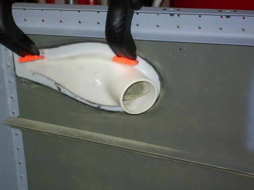

Mix and apply tank sealant to the flange around the VENT SV-1 Remote Vent. Center the vent around the NACA shaped cutout in the F-1069-R Forward Side Skin then clamp the vent in place and let the tank sealant cure.
35-10 Completed per plans

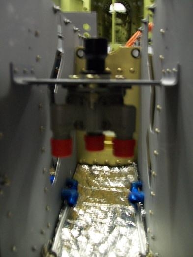

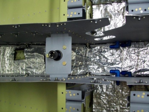

I'm using an Andair fuel valve instead of the standard valve supplied by Van's. I had to fabricate a new mounting bracket to accomodate the Andair valve. I was able to modify the existing bracket from Van's.
I ordered the missing AN 6D spacer today, so it will be about a week before I can complete the remainder of the tasks on this page.
Right forward NACA vent
Andair fuel valve installed in the tunnel
A blurry view of the fuel valve from the front
