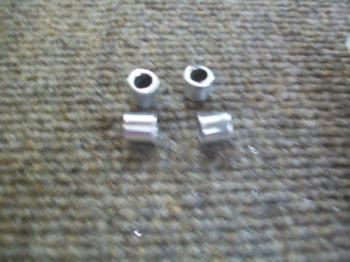

Create four F-1097 Spacers from AT6-058X5/16.

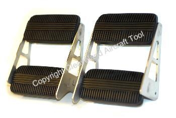

Since I’m installing Sure-Grip Brake pedals from Effectus Aeroproducts, a fair number of the standard build processes aren't required.

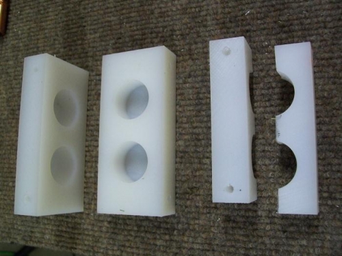

Locate the F-6115 Rudder Pedal Bearing Block. Unlike the other bearing blocks the holes for the rudder pedals pass all the way through the part. Using a drill press, drill #10 two holes through the rudder pedal bearing block.
Cut the F-6115 Rudder Pedal Bearing Block in half.
Clamp the F-1039B Bearing Block Mount Plate to the F-1039A Rudder Pedal Bearing Block. Match-Drill #12 the holes approximately 1/8 deep into the bearing block. Unclamp the parts, then use a drill press to finish drilling both holes #19 in the bearing block. Repeat this step with the remaining mount plate and bearing block.
Final-Drill #12 the remaining holes in the F-1039B Bearing Block Mount Plate. Deburr the holes and edges of the bearing block mount plate. Prime the bearing block mount plate if desired.
Rudder pedal bearing blocks
F-1097 spacers
F-1097 spacers
Sure-Grip Brake pedals from Effectus Aeroproducts, purchased through Cleaveland Tools
