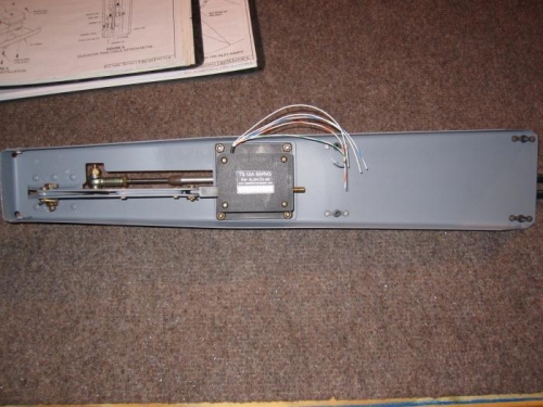

Brief Description:  Trim Bellcrank Assembly #1
11-09, Steps 1, 2, 3, 4, 5, & 6
Run a #30 drill through all holes in the two F-10950 Trim Servo Links and the F-109SE Trim Servo Link Spacer. Oeburr all holes and edges of the trim servo links and trim servo link spacer. Assemble the trim servo links and trim servo link spacer.
The holes in the trim bellcrank are Slightly undersize; run #30, #12, and 1/4" drills through the appropriate holes to bring them to full size. Deburr the holes. Temporarily install the trim bellcrank between the trim bellcrank brackets. Check for free rotation of the trim bellcrank with minimum side-play. The spacer washers may be reduced in thickness if there is rotational binding. The spacer washers may be replaced with thicker washers if there is excessive side-play. Permanently install the trim bellcrank.
Enlarge the four mounting holes in the Trim Servo by drilling #28. Using a file, reduce the thickness of the actuating lug on the trim servo until it fits the gap of the F-1095D/E Trim Servo Link subassembly. Attach the F-10950/E Trim Servo Link Sub-Assembly DRILL #28, to the trim servo.
Install the Trim Servo to the F-1095A Trim Mount Bracket and F-1095F Trim Servo Spacer. Attach the F-1095D/E Trim Servo Link Sub-Assembly to the F-1095B Trim Bellcrank.

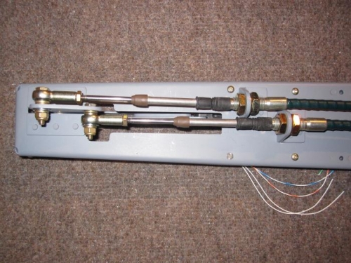

Install the two CT 0-43 Elevator Trim Cables through the F-1095G Trim Cable Anchor Brackets. Adjust the trim cable jam nuts so as to center the threaded portion of the trim cable on the trim cable anchor brackets.
Step 6: Study Figure 5 until you understand the attachment of the threaded ends of the two CT Q-43 Elevator Trim Cables to the F-1095B Trim Bellcrank. Pay particular attention to the orientation of the bolts and the placement of the various washers. Attach the threaded ends of the two CT Q-43 Elevator Trim Cables to the F-1095B Trim Bellcrank. Leave the trim cable jam nuts finger tight.
Underside of Trim Bellcrank Assembly
