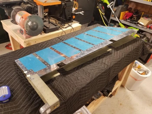

Brief Description:  Riveting the Left and Right Elevators

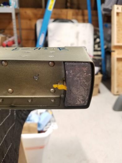

I continued working on the elevators today. I riveted the skin for the right elevator to the understructure. I then finished attaching the E-714 counterweight. It was torqued to 25 in lbs and torque seal was applied.

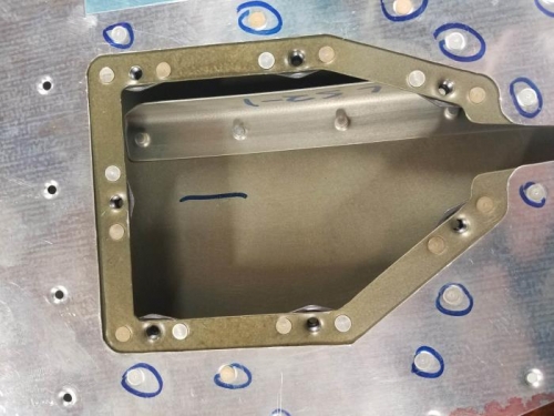

I dimpled the reinforcement plate for the trim tab cover and riveted that and the nut plates on to the left elevator skin. I also built the bracket for the trim tab servo on the back of the cover plate.

I began riveting the left elevator skin to the understructure.
