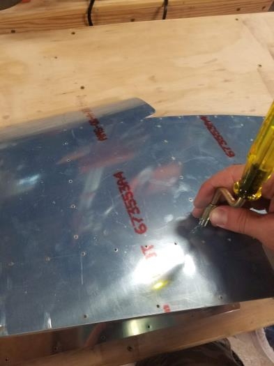

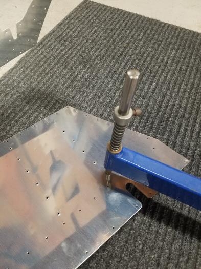

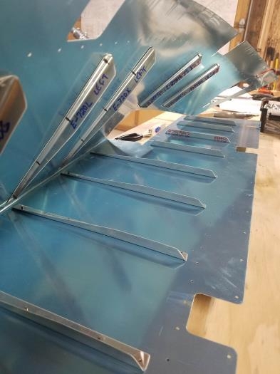

Today I started by finishing drilling the stiffeners to the right and left elevator skins. I then disassembled the skins and stiffeners, deburred all the holes and then dimpled the skins using the c-frame and the stiffeners using the pneumatic squeezer.
