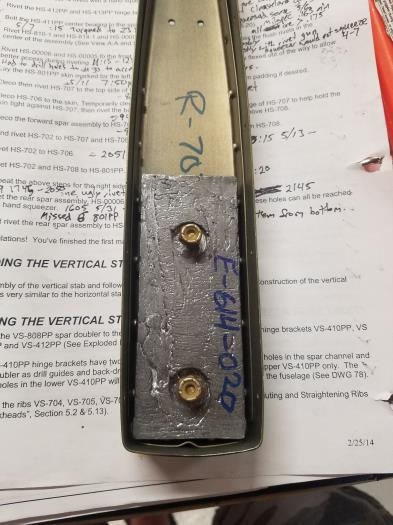

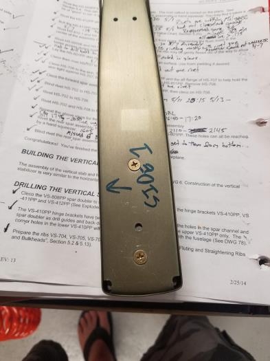

Today I completed the majority of the riveting on the rudder. I first riveted R-713 to R-703. I enlarged the 3/32 guide holes in R-703 to #12 and installed the E-614-020 lead counterweight. I dimpled the holes and countersunk the counterweight so that the screws sat flush and then removed the counterweight.
