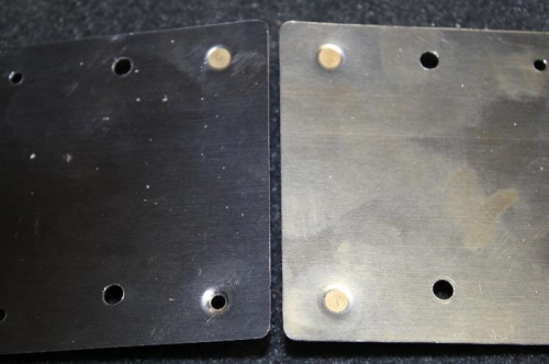

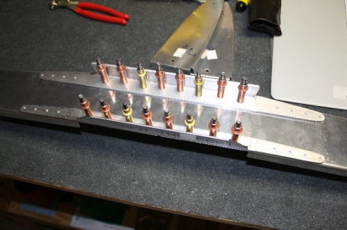

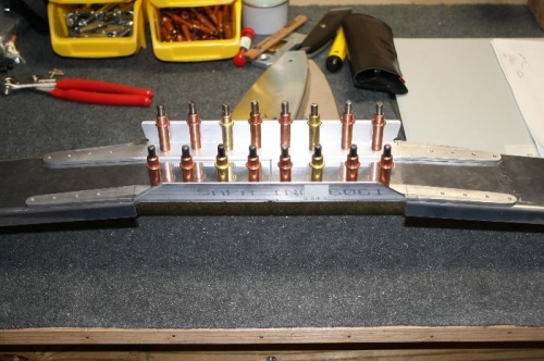

Dimpled center four holes on the HS-702 spar channels. Countersunk center four holes on HS-810-1 reinforcement angle and HS-814-1 splice angle. Front spar assembly almost complete.
