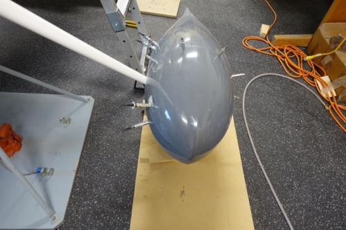

Brief Description:  Wheel Pants
I continued work on the right wheel pant but ran into and issue that required a couple of steps backwards. Van's has you align the center line of the pant with the tire. They also provide vertical dimensions to align the pant at the tail, mid point and nose. The instructions state the dimension in all three locations to be equal. The problem is the center dimension will not allow the pant to align properly with the tire. So, I pulled the right pant and filled the drilled holes in order to correct the error. I went to work on the right pant and got it properly aligned and drilled. I finished work by applying the flox filler between the pant and the mounting bracket.
