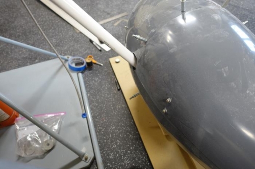

Brief Description:  Right Wheel Pant Installation
Continued mounting the right wheel pant assembly. A lot of back and forth today. I got the pant properly leveled and the longitudnal alignment set. I drilled four #40 holes in the mounting bracket and then used the magnets to locate the drill points on the exterior of the pants. I put a spot of glue on the supplied plastic washers to provide a fixed drilling point.
