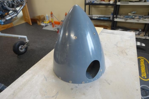

Date:  12-23-2020
Number of Hours:  2.20
Manual Reference:  47-3
Brief Description:  Spinner
Fabricated the backing plate for the gap fillers. Installed the two associated nutplates. Riveted the gap fillers to the rear backing plate. Countersunk all the attach holes for #8 tinnermann washers. Reinstalled and safety tied the forward mounting plate to the prop.
