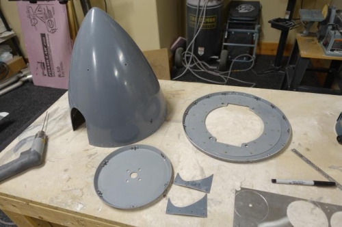

Brief Description:  Spinner
I removed the spinner and drilled the front and rear plates to size and installed the associated #8 nutplates. I trimmed the excess fiberglass aft of the back plate. I fit and drilled the two gap filler pieces to the back plate. I removed the prop from the airplane.
