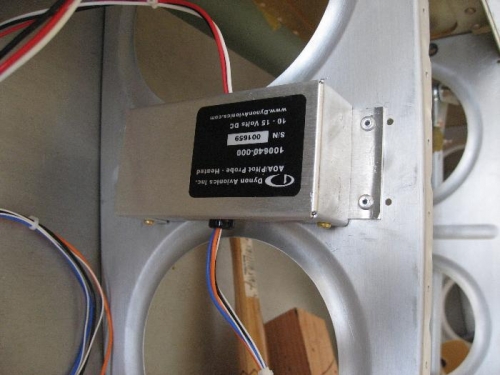

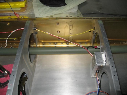

Date:  5-13-2009
Number of Hours:  6.00
Brief Description:  Install Dynon pitot tube heater controller
Mounted the Dynon pitot tube heater controller and ran the power wire. Grounded with a pop rivet, but I'm redoing all pop rivet grounds following BobNuckolls' advice:
