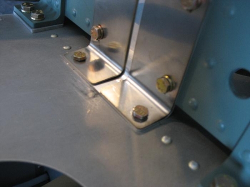

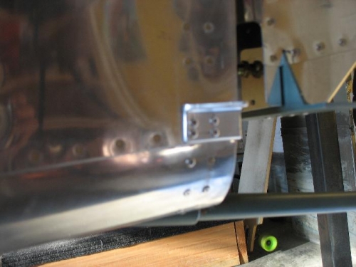

Brief Description:  Rudder stops and VS bolts
Manufacured the Rudder stopps today..... Twice. Made the wrong cut and angle for the stopps, so I did them over. Install was pretty easy, very difficult to get to with rivets so Pop Rivets were used, It shoul be good.. Also installed the bottom bolts the the VS doubler, I was having problems getting them to fit because the bolt was tight against an angle on the bottom side, however I was able to attach the nut and washer by spinning it on as the bolt slid through the top. What a Pain
