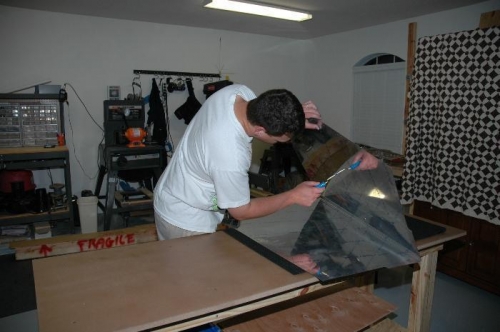

Brief Description:  Match Drilled VS Skin and Debur
Tonight, I continued working on the Vertical Stabilizer. The first step was to drill #40's through the holes that were common between the skin and the skeleton. That was fairly easy; the only tough part was squeezing so many clecos in such a short time. I think I'm going to paint the plane spinach green, because I'm going to have arms like Popeye when I'm done.
After drilling, I removed the skin and started deburring. I deburred the holes (inside and out) on the skin. They feel pretty good now.
There were some stamp marks on the edges of the skin, so I went ahead and deburred the edges too. I pulled a mill file the entire length of the edges, followed by a burnishing tool, followed by the scotchbrite wheel. That did the job of taking the jagged edges away and created a nice edge. (I didn't invent to process, I got a tip at the last Houston RV builders gathering.)

Debur, Debur, Debur.  I'm glad I'm planning to go with quickbuild wings and fuselage.
