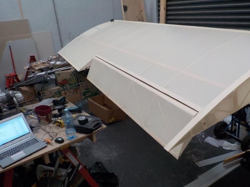

I am setting the final positions for the pulleys and a few other items to finish off welding tabs on the fuselage here and there. Am able to fit on one wing at a time inside the factory.

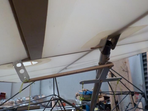

I have mounted the forward pulley on the inside of the strut fitting and the cable is going to travel in between the two fittings as this was the more direct route to the aileron bell crank which has a 'test stick' to the aileron horn. Was good to see movement when activating the lines.
Mounted wing
Mounted wing
One inside, one outside
