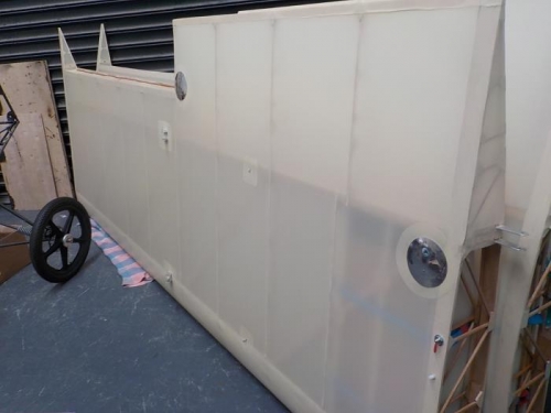

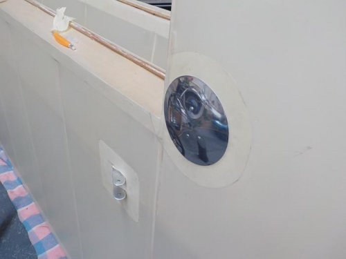

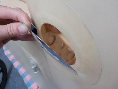

The AS&S inspection cover (Part # 09-19300) is very light weight and the tabs riveted to the underside slide inside the wing behind the plastic ring and hold the contoured cover securely in place. I have started with one at the aileron hinge and fuel tank outlet on both wings. May add more at the strut and wing fittings.
Clip in place
Clip in place
Contoured cover
Contoured cover
