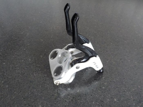

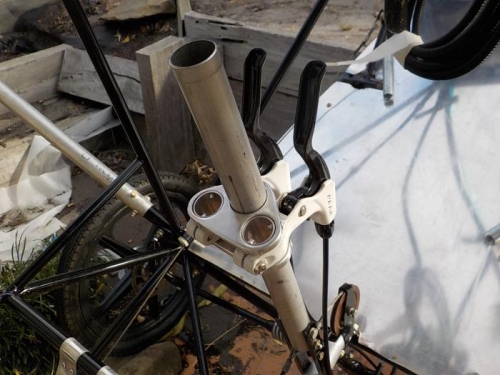

For ease of ground handling I have chosen to go with duel brake levers.
The mount was straight forward to make from aluminum plate and short tubes.
Top and bottom mounts, holes drilled through for the tubes that the levers clamp to and then one for the control column.
Rivet together and then slide onto the column.
I ended up turning the mount and levers through 180 degrees as the levers were too close to the column and interfered with my hand position. Photo to come.
Brackets

Fitted
Fitted
