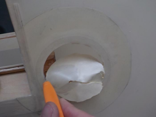

Brief Description:  Inspection cover
One thing I have noticed on the plans is the absence of inspection access points in areas such as the inner aileron hinges. I also need to access the fuel tank outlets where the hoses are secured to the barbed fittings.
The AS&S inspection cover ring (Part # 09-19200) is glued in place using the Oratex Hotmelt method and a reinforcing patch is then glued over the top and heated to activate the adhesion process. The inner circle is cut out using the hobby knife and there is now an inspection hole which allows access to insert the aileron hinge and then safety wire it.
Clear plastic ring
Clear plastic ring
Remove inner fabric
Remove inner fabric
Inspection hole
Inspection hole
