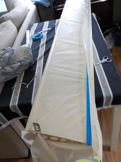

Brief Description:  Aileron covering

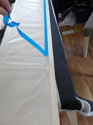

The other side of the aileron covering is ironed/heat gunned to the trailing edge and then flipped over and done again to a second layer of masking tape which overhangs the previous by about 2mm. The second layer of tape is removed and the fabric cut to the original tape line. This tape is then removed and the heat gun and felt pad smooth down the last 2mm of fabric.

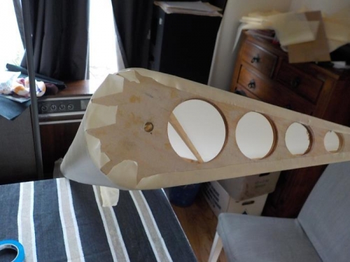

Fabric at the tight radius gets pleated.
Heat to second layer of tape
Remove first tape
Remove first tape
Pleat
Pleat
