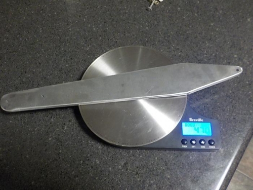

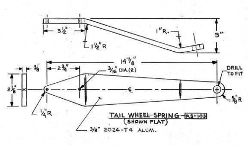

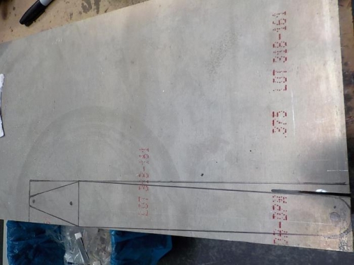

Light weight is always a consideration when building an ultralight aircraft which is why I chose to make the tailwheel spring from 3/8" thick 2024 aluminium as has been done with Hi-Max aircraft. The cost is maybe $15 and it weighs in at 1 pound.
Hi-Max plans
3/8" 2024
470 grams / 1 pound
