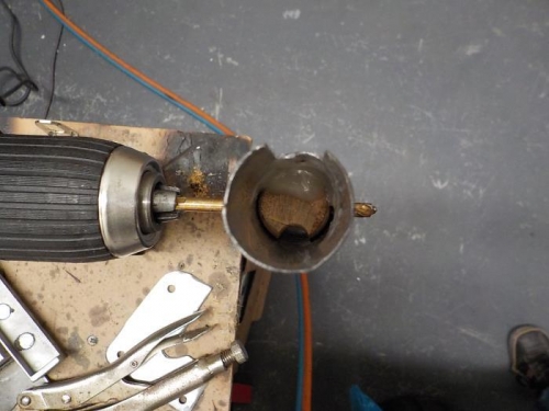

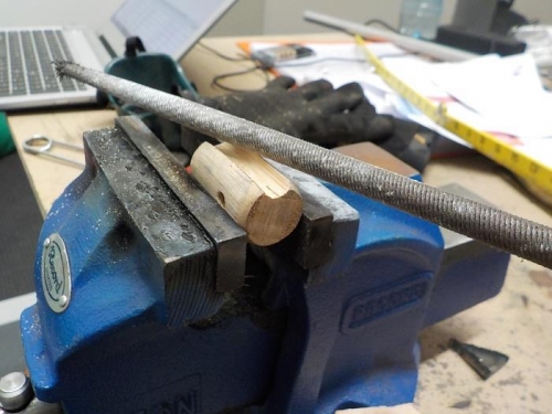

The wood filler is nothing more than the tip of a broom handle which I then filed down to create a notch for the cable to pass through. Epoxy holds it in place whilst the drill bit keeps it centred when drying.

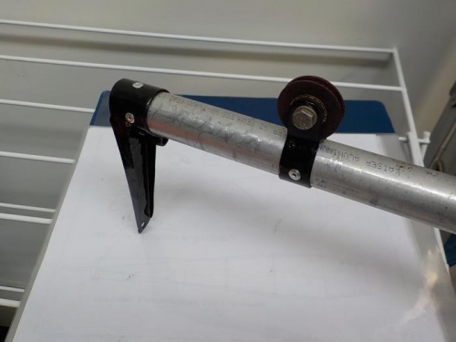

Aileron arm and 1" pulley are aligned and riveted.
File
File
Epoxy
Epoxy
Riveted
Riveted
