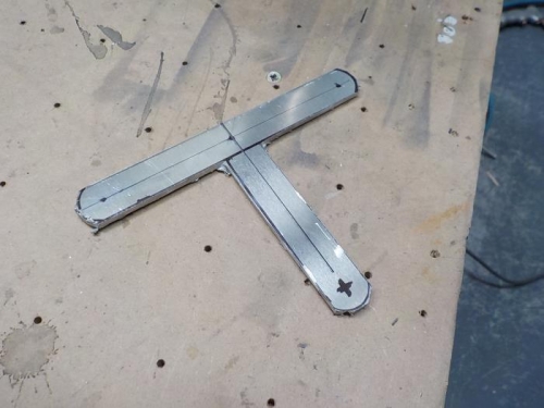

Brief Description:  Aileron horn
Cut the aileron horn from 1/8" 6061-T6 sheet, drilled the 3/16" holes and then smoothed the edges with the Scotch-Brite wheel. Yet to make a bushing to give more clearance so it stands off the strut so nylon washers will do just to test the action.
Aileron horn
Aileron horn
